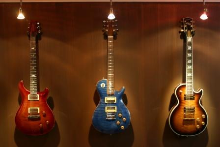

The body design was a blend of a PRS and a LES Paul...so this picture is interesting.  Essentially, all I can see for next time is to reduce the size of that blasted upper bout...it is a little bigger than I thought.

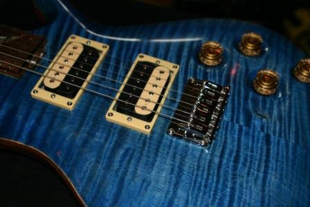

Nice Electric design...a very cool mix of LP and PRS...Did you do anything different as far as the electronics? At first glance it looks like the pickups are really close together which would limit the difference in string sound but I see that you have the p/u's reversed so it gives you more distance.

Shawn - honestly, when I first positioned the pickups, I knew no better...That will change in the guitars to come.  What I did with the wiring was a combination of a great many standard methods.  I made it possible to tap both pickups, which gives some good tonal variation.  Additionally, I added a small capacitor on the volume pots to bleed some of the treble off at the low volume end - so it would be more consistent across the volume board.  I also swapped volume - 3 way - tone connections to provide for individual volume control when both pickups are activated.  Aside from that, I work for a prototyping engineering firm, and we recently bought crate loads of a company's old stuff - in it were boxes of mixed up orange and green drop caps...so I experimented with them to better attenuate certain frequencies based on the pickup position...blah.  I had some fun and learned a great deal.
